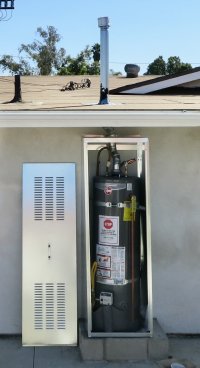

There's 10-15 items to check. I have seen a garden hose hooked up to the PRV and I have seen plenty of WH's with no drain line attached to the PRV, flues touching floor joist with no protection. I have seen copper gas lines, no disconnects within site, unions, rocking tanks and valves missing. So ther's a reason to issue a permit and do the inspections.

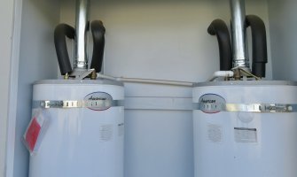

The pictures of the double WH in post #8 … they tied the t&p together? Is there a hidden t and down pipe behind the wh?
That is a lot of photos by ICE of water heater installations. I did not see any violations but they are nice photos nonetheless.

Almost all of the pictures have been posted at the forum previously in the Average Day thread. Every picture has at least one violation. 28 picture = easily 65 violations.
