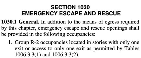

Section 1029.1 indicates that emergency escape and rescue opening are required for basements and sleeping areas below the fourth floor. That would seem to indicate that the fourth floor does not require the egress opening. Operational constraints are covered by Section 1029.4 for required egress openings. Do these devises appear on every level or just the fourth floor?
My specific question is if the window needs to be capable of opening past the 4" if the building is sprinklered.
Unless it is a single exit story/building, I don't think so. 2012 was a little less understandable IMO, but I believe the intent was the same then as the 2018.

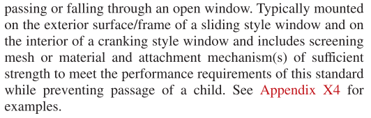

One is that the fall protection that was installed originally in the windows was screwed in so the window had no way of opening past the 4 inches. It also had window slide latches which had also been screwed through in a way that made them inoperable.
All of them are a life safety code violation
1015.8 Window openings.
Windows in Group R-2 and R-3 buildings including dwelling units, where the top of the sill of an operable window opening is located less than 36 inches above the finished floor and more than 72 inches (1829 mm) above the finished grade or other surface below on the exterior of the building, shall comply with one of the following:
1. Operable windows where the top of the sill of the opening is located more than 75 feet (22 860 mm) above the finished grade or other surface below and that are provided with window fall prevention devices that comply with ASTM F2006.
2. Operable windows where the openings will not allow a 4-inch-diameter (102 mm) sphere to pass through the opening when the window is in its largest opened position.
3. Operable windows where the openings are provided with window fall prevention devices that comply with ASTM F2090.
4. Operable windows that are provided with window opening control devices that comply with Section 1015.8.1.
1015.8.1 Window opening control devices.
Window opening control devices shall comply with ASTM F2090. The window opening control device, after operation to release the control device allowing the window to fully open, shall not reduce the minimum net clear opening area of the window unit to less than the area required by Section 1030.2.
Did you check the screens for possible compliance. Cheaper and easier to install then replacing windows.
YI: ASTM F2090 is an easy 15 page read.

The window as an emergency escape and rescue opening wouldn’t be required in a 4-story R-2 building because stories with a single exit wouldn’t be allowed in a 4-story building.
I have not been able to locate any code in regards to that hunch. I was hoping someone may be able to help me with that.
Admittedly, I think the code is sloppy here. 2018 and beyond appear to have made an attempt at clarifying it. It first lists where the EERO's are required, then provides a paragraph adding to it, but only if the 2 conditions are met. I think this is confirmed by the following interp:

Emergency Escape and Rescue openings as @ICE just referenced (1031 in my current code). This is so people can get out, or (rarely) so rescuers can get in.

Since this is in the context of a code enforcement issue, first determine if they are required to be EERO's and it sounds like they are. Then, when it was built, would they be required to have fall protection, it sounds like that's also a yes. Based on that I would absolutely cite the missing devices as code violations.
