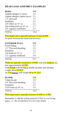

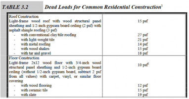

This is something I was looking for:
  • House Self weight IntroLoadPath.pdf
