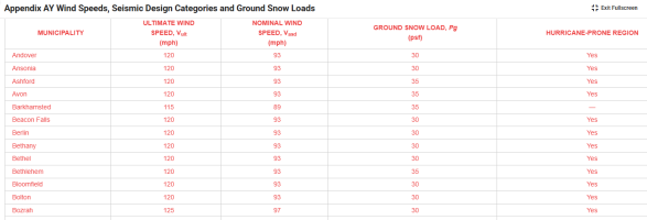

And I guess if it can't be a local amendment, can it be a local modification or policy?
R104.1​
The building official is hereby authorized and directed to enforce the provisions of this code. The building official shall have the authority to adopt policies and procedures in order to clarify the application of its provisions. Such policies and procedures shall be in compliance with the intent and purpose of this code. Such policies and procedures shall not have the effect of waiving requirements specifically provided for in this code, nor shall they have the effect of establishing requirements in excess of those set forth in this code.
R104.10​
Modifications, variations, or exemptions from and approval of equivalent or alternative compliance with the requirements of this code shall be in accordance with the provisions of Sections 104.10.1 to 104.10.4, inclusive.
R104.10.1​
Pursuant to subsection (b) of section 29-254 of the Connecticut General Statutes, the State Building Inspector may grant modifications, variations or exemptions from, or approve equivalent or alternative compliance with, the Connecticut State Building Code where strict compliance with the Connecticut State Building Code would entail practical difficulty or unnecessary hardship, or is otherwise adjudged unwarranted, provided the intent of the law shall be observed and public welfare and safety be assured. Any person aggrieved by any decision of the State Building Inspector may appeal to the Codes and Standards Committee not later than 30 days after mailing of the decision.

I'm a 3rd party inspector that works in multiple towns. Local amendments can be a big deal here since the state only requires a permit for 1 & 2 family homes and townhouses, only when something structural is done, an accessary building is over 1,000 sq ft. or when a deck is over 30" high or building a pool or spa. I think less than half the local towns have local amendments. Some locals even adopted the IFC which the state didn't. We have one town that adopted the IFC but refuses to enforce it. In most of the state you can rewire, upgrade the service, put in new HVAC and all new plumbing in a house without a permit but when the locals amend the code, we have a lot more inspections to do.
