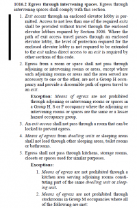

Electrical rooms with equipment rated 1,200 amperes or more and over 6 feet (1829 mm) wide that contain overcurrent devices, switching devices or control devices with exit or exit access doors shall be equipped with panic hardware or fire exit hardware. The doors shall swing in the direction of egress travel.

2012 IBC TABLE 1018.2 MINIMUM CORRIDOR WIDTH
Access to and utilization of mechanical, plumbing or electrical systems or equipment minimum corridor width is
24 inches
Although this seems pretty narrow that is all that the IBC requires

If they are fire rated spaces each one separated from each other, I would agree this is a horizontal exit.
