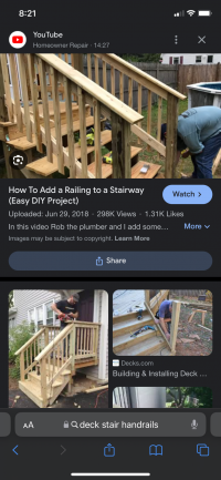

Well, certainly not graspable. Of not much use to some one with arthritis. They'll have to renter the house afire and find "the" means of egress.
Doesn't make it right or safer. Meeting code minimums is just a passing grade, D-, and I guess I'm just cursed by a desire to do better.
I’d agree. I just can’t find anything that says I can fail it. It meets the minimum passing grade.
