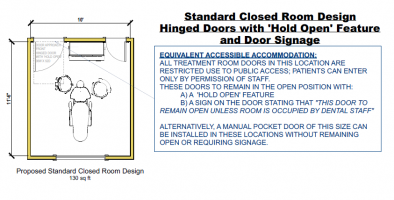

Hello,
IBC 2018 and ANSI 117.1 2017
Some architects are doing this in some states and I have adopted it for our design work. The main theme being that the dental treatment room is a an area of 'restricted use to public access in that the public / patient can only enter by permission of staff'.
The solution on a hinged door to avoid the requirement of 18" clear on the latch pull side of the door is to a) have a 'hold open' feature on the door and b) have a sign indicating as described above.
Your thoughts?

Well I don't know exactly? The architect noted it acceptable at their local plan check as 'equivalent accommodation'.
Your thoughts?
As long as there is no automatic release of the hold open in the event of a fire or smoke alarm going off I do not see an issue.
Think of a patient who uses a walker is left in the room by themselves while the Novocain takes effect and an emergency happens. Will they be able to get out by themselves.
I agree, provided the door is not required to be fire-rated.
For ANSI, it will be a matter of getting the building official to accept it. For ADA, it will be up to the DOJ should someone file a complaint. You could get advice from the Access Board's technical assistance.
Good points. . . I did contact the Access Board so we'll see if they salute. Thank you!
An update. I spoke with Bobby at the Access Board and he didn't think there was any problem with interpretation as 'equivalent accommodation'. However, he did advise me to contact DOJ to see what their interpretation might be. FYI
