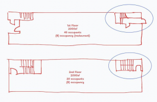

The following is a 2 story, non-sprinklered Type VB.
1st floor: total renovation
2nd floor: existing
Question: Per 1019.3 exception 1, can that stair, circled in blue below, be un-enclosed and unrated?
Thank you Kindly, Ryan
Could the counter argument be that the wall around the stair is actually a corridor wall, that might need to be rated per TABLE 1020.1--as the (65) occupant load is greater than 30 occupants?
If the stair is allowed to be unenclosed then the wall shouldn't be necessary. However, if a wall is provided (maybe for separating downstairs & upstairs tenants) then it probably needs to be rated, since the exceptions of 1028.1 don't seem to apply.
