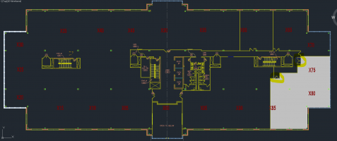

I have a suite, after the original space was demised, left with only one exit. The common path of travel (furthest point to spot where I have access to two distinct exits or exit access doorways) exceeds 100'. It is 125' to the exit stairway, which means I need two exit access doorways out of the space. I can't find anything that disputes my solution below, but both of these lead to the same corridor behind the exit and my travel distance to the exit is still 125' (below the 300' of a sprinklered business occupancy). I could see the logical argument that these two exit access doorways still leave you with the exact same situation you had when you only had one doorway, effectively leaving a single opening into the space, a corridor outside of the space vs within the space. However, I can't find anything that says this isn't permissible. The space in question is the gray shaded area and the two exits out of the space are the required remoteness.

The corridor is not rated, the building is sprinklered. I don't think you can make an "existing building argument" because the former space did comply, no one made us demise it like this. A colleague of mine reviewed the plan when the space was demised and made the mistake of thinking the common path of egress was to the exit of the suite, not at the point of decision where you had two choices of exits.

If this is the case, I believe your initial post is correct: your common path measures to the entrance of the nearest stair tower (exit) since both egress paths converge. The only viable option I see is to create an Exit Passageway from both of your Suite doors up to and including the nearby Stair tower Door.
But if you go out the "left door" you have to walk by the "right door? I would not call that a choice of 2....
I found this in the ICC committee interpretations, which I would say backs up the not being able to provide 2 exit access doors before you get to the point of decision, even if it is not implicitly stated.
That is unfortunate. You have converging exits. Your Common path length will not comply and would not be allowed in our jurisdiction. Unless you are on the ground floor and can provide a direct exit to the exterior I see no solution that would not involve impacting the adjacent tenant area to provide another corridor to allow exiting in two directions that do not converge.
Yes, we have also considered that as well, leasing doesn't want to lose the ability of providing glass suite doors (without having to pay lots of money for rated glass doors. I suggested giving away the corner of the space that isn't within the 100' of C.P.O.T. which equates to around 250 sf, but over the 10' year lease of the tenant to the left, it's 75,000 dollars in lost rent, so leasing wasn't crazy about that. The interior designer on the project is trying to rework the adjacent tenant plan as an option, but lease has already been signed.
I believe the code commentary version has diagrams indicating that this situation is not code compliant.
If they do, I haven't been able to find it. They only give uncomplicated examples. I did find some further interpretation from ICC under their committee interpretations, intent of the code is if there is a fire emergency that the paths do not collide. My last-ditch solution is out!
page #397 of the 2021 IBC Illustrated Handbook has the most relevant diagram for your situation
Could the door at X75 open directly into the corridor, and the other door have a minimum width corridor going to the left of the stair instead of the right? That would let you get to the center stair without passing the right stair.
