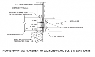

There is a mention of flashing for exterior decks in R507 but it only mentions minimum thickness and type of material, not that it has to be done or how it must be done. The roofing sections of the code are very good about this. I am surprised that as many revisions in R507 since its birth as a new section did not bring forth this requirement.
There are two figures, one shows what I can assume is flashing and the other figure calls out flashing but does not show it.

Screen Shot 2023-12-06 at 16.37.16.pngScreen Shot 2023-12-06 at 16.37.25.png
TABLE R507.9.1.3(1)
Footnote a. Ledgers shall be flashed in accordance with Section R703.4 to prevent water from contacting the house band joist.
TABLE R507.9.1.3(1)
A footnote? Footnote "b"
This should have its own section that is prominently displayed and not hidden in a footnote like a secret or at the very least in the code like this:
R507.9.1.1 Ledger details.​
Deck ledgers shall be a minimum 2-inch by 8-inch (51 mm by 203 mm) nominal, pressure-preservative-treated Southern pine, incised pressure-preservative-treated hem-fir, or approved, naturally durable, No. 2 grade or better lumber. Deck ledgers shall not support concentrated loads from beams or girders. Deck ledgers shall not be supported on stone or masonry veneer. Ledgers shall be flashed in accordance with Section R703.4 to prevent water from contacting the house band joist.
R703.4 Flashing.
Approved corrosion-resistant flashing shall be applied shingle-fashion in a manner to prevent entry of water into the wall cavity or penetration of water to the building structural framing components. Self-adhered membranes used as flashing shall comply with AAMA 711. Fluid-applied membranes used as flashing in exterior walls shall comply with AAMA 714. The flashing shall extend to the surface of the exterior wall finish.

All of these flashing details assume the structure has sheathing behind the siding or stucco. What do you do when you have a structure with wire backed plaster (or wood siding attached directly to studs) and no sheathing (typical 1950's post war homes)? Seems too invasive to open up a large chunk of wall instead of just lagging into the rim joist and use stand offs (Deck2Wall spacers for airspace) to hang the deck ledger.
Short Answer: Locate the framing members. Fasten to the structural members. Flash or space ledger away from wall to allow water to pass behind the ledger without penetrating the wall membrane.
Best Answer: Upgrade the exterior wall sheathing and cladding and Flash according to FEMA Technical Fact Sheet No. 23.
