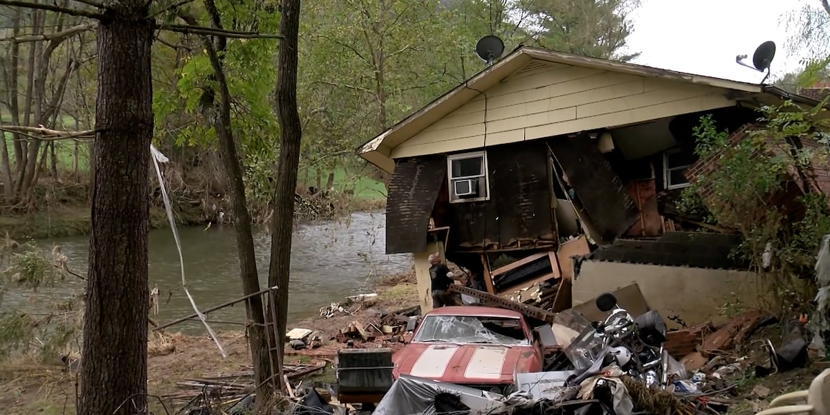

CHARLOTTE, N.C. (WBTV) - When Kim Wooten sees the devastating videos of Helene’s destruction, she thinks about her five years serving on the North Carolina Building Code Council.
Trickling streams in the mountains turned to raging rivers after the hurricane dumped record setting rain. The world has watched as flood waters wiped away roads, homes and entire neighborhoods.
Wooten thinks about the various building code updates that have been blocked or excluded. Codes that could have made some of the structures safer.
“It’s the General Assembly and the North Carolina Home Builders Association,” Wooten said. “Both of those entities have effectively blocked the ability of homebuyers to purchase a home that is built to modern standards, that has been inspected to meet modern standards, that is efficient and affordable.”
A WBTV Investigation is shining a light on how North Carolina lawmakers and lobbyists weakened the state’s building code for years before Hurricane Helene hit. The history reveals a pattern of bills sponsored by legislators who own construction companies, supported by a political action committee that has spent more than $4 million over four years on their preferred candidates.

I noticed a lot of houses that were floating in the current that were largely intact, which tells me that their racking strength is better than their anchorage. Not that it really matters, if they had been anchored better they would have been smashed to matchsticks.

Here are some photo's for thought, but I doubt anything they gutted from the NC code, though truly helpful in the long run, would have saved any of the homes from the water slides and washouts they got hit with.
Water goes where water wants!
