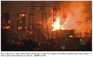

When a massive fire erupted at one of the world’s largest lithium-ion battery storage facilities in Monterey County, it didn’t just send plumes of smoke over nearby communities — it cast a pall over the future of California’s clean energy industry.
The fire at the Moss Landing Power Plant, which ignited on Jan. 16, burned for five days and ultimately destroyed around 80% of the batteries inside the building. Now, as the smoke clears, Monterey-area officials warn that the blaze may be a harbinger as the state increases its reliance on renewable energy, electric vehicles and other battery-powered devices.

Several factors contributed to the rapid spread of the fire and complicated firefighters’ response, according to North County Fire District Chief Joel Mendoza.
  • A fire suppression system that is part of every battery rack at the plant failed and led to a chain reaction of batteries catching on fire, he said at a news conference last week.
  • Then, a broken camera system in the plant and superheated gases made it challenging for firefighters to intervene.
  • Once the fire began spreading, firefighters were not able to use water, because doing so can trigger a violent chemical reaction in lithium-ion batteries, potentially causing more to ignite or explode.
