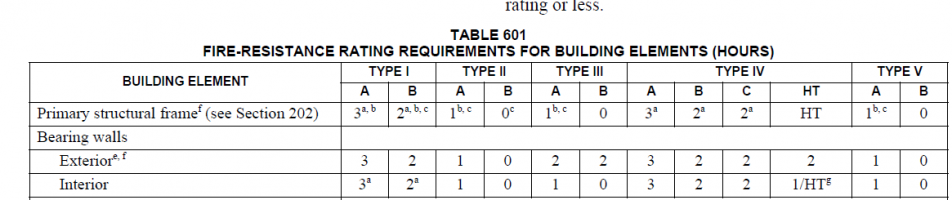

Type VA construction using 2015 IBC, bearing walls which are not fire barriers, fire partitions or fire walls clearly must be 1-hour rated per Table 601. The walls we are looking at here are typically wood-framed bearing and/or shear walls within R-2 dwelling units in mid-rise 6-8 story V-on-I buildings. The door might easlily be from bedroom to living room.
Do the studs around openings in these walls need any sort of protection?
We have a building inspector requiring that the non-rated door openings in these walls be wrapped with GWB or get an additional stud at each side to protect the edges of the 1-hour-rated GWB-studs-GWB sandwich from fire.
The walls are not formally protecting anything on one side of the wall from a fire on the other side, they are protected solely due to their structural role.
CAN THIS POSSIBLY BE CORRECT?
Section 602.1 hints that these stud wall edges do not need protection:
  • Where required to have a fire-resistance rating by Table 601, building elements shall comply with the applicable provisions of Section 703.2. the protection of openings, ducts and air transfer openings in building elements shall not be required unless required by other provisions of this code.”
But of course there is that “unless required by other provisions of this code” text. We have not been able to prove there is NO OTHER PROVISION, so we are stuck
If these walls were secondary structural members, then I also believe that 704.4.1 would give us permission to say that the fire resistance ratings are provided by the GWB membranes, and that the edges of the openings do not need special treatment:
  • Studs and boundary elements that are integral elements in load-bearing walls of light-frame construction shall be permitted to have required fire-resistance ratings provided by the membrane protection provided for the load-bearing wall.”
I spoke with our structural engineer, and alas they were not able to say with any confidence that these bearing and shear walls are “secondary.”
Anyone got an opinion?
The inspector is absolutely incorrect. Each of the FRR assemblies have specific requirements for openings, membrane and through penetrations. Bearing walls have no requirements for openings (or penetrations). Your interpretation is correct. This follows the intent, they are not designed to compartmentalize a fire, only to maintain structural integrity for the required time. While penetrations and openings can reduce that, they will still maintain capacity for the duration required.

704.4.1 Light-frame construction. Studs, columns and
boundary elements that are integral elements in walls of
light-frame construction and are located entirely between
the top and bottom plates or tracks shall be permitted to
membrane protection provided for the wall.
You may be able to approve an alternate via 703.2.3 and 104.11....but bear in mind that is you "approving" an alternate.......When the framing is not protected by the membrane (drywall/ gypsum)....

So by your idiot logic, we could drywall the 1.5" face of 2x4s, leave all of the sides exposed, call them "openings" and have a 1 hour rated bearing wall?...... Rated openings in an assembly designed to prevent the spread of fire to other parts of the building and rated structure that keeps the building standing in a fire event are 2 entirely different things....Use your head.....704.4.1 says that can be accomplished by the membrane that COVERS the framing....What exempts the "exposed" or non- fire protected per 704.4.1 framing from being 1 hour protected?
