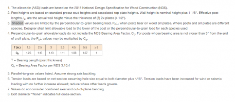

  7. jamzm
    jamzm Registered User
    Joined:
    Sep 11, 2019
    Messages:
    17
    Likes Received:
    1
    Trusses resting on 2x6 on llv on bulkhead. Many of the homes in our plan have sagging garage door headers installed like this.

  9. jar546
    jar546 *****istrator
    Joined:
    Messages:
    7,704
    Likes Received:
    724
    What is supporting the corner of the 2nd floor? Any more photos?

  11. ADAguy
    ADAguy Registered User
    Joined:
    Sep 11, 2013
    Messages:
    4,702
    Likes Received:
    449
    How are the trusses attached?
    Is this a oneoff or part of a tract of new homes?
  12. jamzm
    Joined:
    Sep 11, 2019
    Messages:
    17
    Likes Received:
    1
    Steel beam
  13. jamzm
    Joined:
    Sep 11, 2019
    Messages:
    17
    Likes Received:
    1
    New house in an existing plan
  14. jamzm
    Joined:
    Sep 11, 2019
    Messages:
    17
    Likes Received:
    1
    It looks like the trusses were nailed to the 2x6 on top of the LVL, sorry

  19. e hilton
    e hilton Bronze Member
    Joined:
    Jul 2, 2014
    Messages:
    1,027
    Likes Received:
    242
    As long as the lvl is sized correctly for the anticipated loads, and the trusses are properly attached to the lvl, and the columns supporting the lvl are correct ... I don’t see a problem.
  20. jamzm
    Joined:
    Sep 11, 2019
    Messages:
    17
    Likes Received:
    1
    But if there's not a problem, then why are a high number of these spans sagging?
