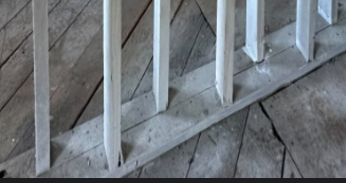

1hr party wall assembly with no airgap and staggered studs?
Let's "repair" the plumbing with lead solder too!
They're building a new wall, it needs to meet the current building code, it's not even gray.
Show me yours ill show you mine...
P2906.2.1​
Pipe, pipe fittings, joints, valves, faucets and fixture fittings utilized to supply water for drinking or cooking purposes shall comply with NSF 372 and shall have a weighted average lead content of 0.25-percent lead or less.
This does not look like a new plate, so I ASSUME not a new wall..And it looks very gray to me...maybe white.....:
P2906.2.1​
All the parts that make it sound compliant will be new work. QED

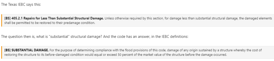

This is why I asked if this project falls under the 50% criterion. That determines whether it can be repaired with in-kind construction or if the replaced construction has to meet the current code.
50% criterion is not included in Chapter 4 repairs.
301.1 General.
The repair, alteration, change of occupancy, addition or relocation of all existing buildings shall comply with Section 301.2, 301.3, or 301.4.
301.2 Repairs.
Repairs shall comply with the requirements of Chapter 4.

Nope, if we follow Texas IEBC, only a building in a burned condition where repair costs 49.99999999% or less of the pre-damage market value gets to be restored back under the requirements of the code that was applicable at time of original construction. That's what the IEBC considers to be a "reasonable" approach to repairs. In that scenario, the neighbors will hear each other no more or no less than they did pre-fire damage. If the owner wants it quieter than that, then it becomes an upgrade/alteration, not a "repair".

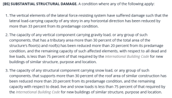

Substantial Damage or Substantial Improvement definitions would not be applicable since this is a fire damage repair and not flood damage repairs.
2018 IEBC
[BS] SUBSTANTIAL STRUCTURAL DAMAGE. A condition where any of the following apply:
1. The vertical elements of the lateral force-resisting system have suffered damage such that the lateral loadcarrying capacity of any story in any horizontal direction has been reduced by more than 33 percent from its predamage condition.
2. The capacity of any vertical component carrying gravity load, or any group of such components, that has a tributary area more than 30 percent of the total area of the structure’s floor(s) and roof(s) has been reduced more than 20 percent from its predamage condition, and the remaining capacity of such affected elements, with respect to all dead and live loads, is less than 75 percent of that required by the International Building Code for new buildings of similar structure, purpose and location.
3. The capacity of any structural component carrying snow load, or any group of such components, that supports more than 30 percent of the roof area of similar construction has been reduced more than 20 percent from its predamage condition, and the remaining capacity with respect to dead, live and snow loads is less than 75 percent of that required by the International Building Code for new buildings of similar structure, purpose and location.
[BS] SUBSTANTIAL DAMAGE. For the purpose of determining compliance with the flood provisions of this code, damage of any origin sustained by a structure whereby the cost of restoring the structure to its before-damaged condition would equal or exceed 50 percent of the market value of the structure before the damage occurred.
[BS] SUBSTANTIAL IMPROVEMENT. For the purpose of determining compliance with the flood provisions of this code, any repair, alteration, addition, or improvement of a building or structure, the cost of which equals or exceeds 50 percent of the market value of the structure, before the improvement or repair is started. If the structure has sustained substantial damage, any repairs are considered substantial improvement regardless of the actual repair work performed. The term does not, however, include either of the following:
Substantial structural damage certainly would be applicable. Nothing in the definition of substantial structural damage limits it to flood damage.
2021 Texas Building Code (per UpCodes):
The definition of "Substantial Damage" you quoted above also appears in the Texas Building Code:
While this starts off by saying "For the purpose of determining compliance with the flood provisions of this code" [which I have not investigated], it then says "damage of any origin sustained by a structure ..." So it doesn't appear that this is limited to flood damage. Here's what the 2021 IEBC Commentary says about this definition:
