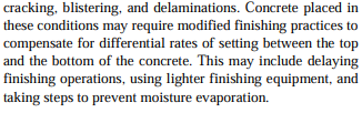

    Also see ACI 301 and ACI 306. ACI 306 is the guide for concrete in cold weather.
    ACI 306 available here
    Per ACI 306 -
