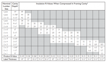

R49 doesn't even fit in a 2x12 (14"), so what do you think they are doing? Nevermind with a seat cut.....Again, you can use conventional framing, but you have to use foam....

Glenn, what is the seat cut at the exterior face on a 2x12?....Maybe 10"? And then there is 14" R49 insulation and a 1" air space to deal with....I know rescheck takes some of this into account, but this section does not and is clear....

The R49 is the gimmie, but the hitch is that it needs to be installed uncompressed....Don't get me wrong, I am not measure rafter depth, but I know what fits and I give the contractors a heads up on plan review that if they don't have room they will be foaming or finding an alternative path...
