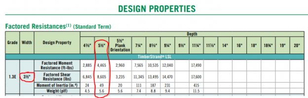

Maybe use parallam engineered wood?
Not at 1.3E for the 16' span request. That condition is going to be deflection limited, so the higher the E the better. That's why SS DF-L (1.9E) is better than #2 DF-L (1.6E). A 2.0E LVL would only be marginally better than SS DF-L. But if there are higher E options available in a 5.5" height, like a 2.2E or 2.3E, that would be worth considering.

I’m building a 2 story apartment inside my existing pole barn and am very restricted on height. I can only use 2x6 for the floor joists. Most of my spans are 10’ or less but a couple spots I need to span 16’. Is there anyway by doubling them or a tighter spacing than 12” oc that will work? I could do LVLs in these areas but haven’t been able to find a span chart for floor joists. I’ll have a live load of 40 psi in one area and 30 in the other.
Any help would be greatly appreciated.
I know your question is specifically looking for a 5.5” structural solution, but are you willing to consider different height clearances either above or below the floor? Would one or two drop beams make the pole barn below unusable? Are you willing to lose a couple inches of headroom in the apartments?
What are the height limitations you’re dealing with?
