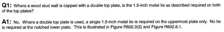

I am guessing it's not possible to run a 3" drain through a double top-plate structural wall, but I
wanted to present that idea. I was planning on putting in another floor joist in the 25" gap, run
the toilet drain down through the structural wall (through the double top plate), nailing a stud
strap on either side of the top plate where the drain cuts through the top plate, add stud
directly under the new floor joist
