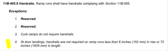

I've got (2) 6 feet long ramps either side of a landing. The ramps are at 1:12 slope and therefore do not rise more than 6". No handrails required....correct?
2018 IBC says if no handrails they need flared sides
Would the configuration shown be considered “ramps that change direction between runs at landings” that requires a 60”x60” landing per ADA 405.7.4?
Does ADA requirements apply? If so, Door swing and maneuvering clearances may affect the middle landing. (ICC A117.1-2017, Section 404.2.3.2.)
The 60” deep maneuvering clearance on the pull side of the door will require a larger landing even if this isn’t considered a change in direction.
If there’s any way to swing one or more doors inward, or to recess them, you could do a 10’ slope hall at 4.9% and then you would only need level door clearances, not ramp landing clearances.
Good idea, thanks! Even though it looks like I can achieve a compliant arrangement with 6' feet segments on both legs, the 5% leg on the top would help. I'm restricted on length on the bottom leg. Door maneuvering clearance in yellow, ramp in green.
