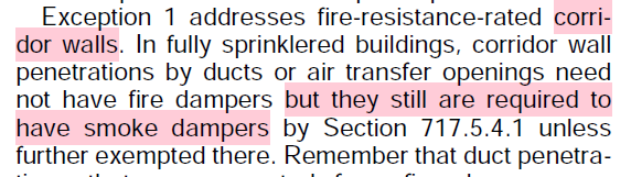

3- There are 4 exceptions to this including one for a corridor. Follow exception 1, fire damper not required.

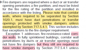

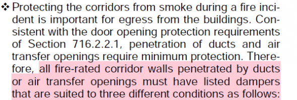

717.5.4 requires a fire damper in fire partitions, unless by exception.
717.5.4.1 requires a smoke damper in corridor walls at ducts and transfer openings when a corridor is required to have smoke and draft control doors per 716.2.2.1. In the post above Q.#8 questioned where that occurs, proposing it is only in I-2 and I-3. Reading 716.2.2.1 it appears that any door assembly in t716.1(2) would be subject to this. The table includes "fire partitions: corridor walls". Wouldn't then, the requirement apply to any rated corridor door?

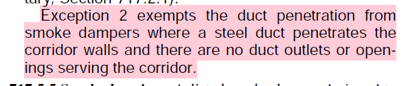

Base code requires a SD in a corridor wall assuming the doors are subject to smoke and draft control, then exception #2 excepts the smoke damper in the corridor wall if the duct is steel and there are no openings serving the corridor. My question is if the corridor is served by 2 different systems.
My current project: R2, VB, NFPA 13R, 3 story, 2018 IBC. The corridor has an unrated lid with an outdoor air system and a supply air system between the unrated lid and the rated floor assembly above it. The OA system is dedicated and has no openings other than steel ducts directly to each unit. There is a FD at each OA system penetration of the corridor/unit wall. The SA comes directly from an FCU with it's own OA and supplies only the corridor via ceiling registers in the unrated lid. There is a return air path in the space above the unrated lid (plenum) but the FCU has smoke detection that shuts the system down.
The FD on the OA system would be required per 717.5.4 base code (assume exceptions don't apply).
The SD on the corridor/unit walls would be required as well unless 717.5.4.1 #3 unless exc. 1) I am wrong that this corridor is subject to 716.2.2.1 or 2) the duct is steel and there are no openings serving the corridor. My question about this exception is the "no openings serving the corridor" part. There are no openings from the OA serving the corridor, but there are openings from the SA serving the corridor, both supply and return. Both systems share the same space. If we read it literally, then the exception would not apply. This makes some sense to me since if there were smoke from a unit, it could travel unrestricted to the corridor plenum through a FD that has not closed, and into the corridor below via the unrated lid and/or open return air. However, since the OA system is closed, the only smoke from the unit would not communicate with the plenum space, it would only fill up the OA system, which is closed. If the exception intends that only the system that is penetrating the corridor/unit wall and that it communicates with the corridor then the exception would apply and no SD required.

Pasting some pertinent commentary:
717.5.4
717.5.4.1
