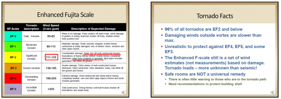

96% of Tornados are EF2 and Below
Forum Coordinator
11,041
Somewhere Too Hot & Humid
I found this information to be important. EF2 tops out at 135mph. Just how much resistance would there be to code changes for minimums in all areas?

Wind loads increase with the square of the wind speed, so designing for 135 MPH instead of 90 MPH (working stress design) would slightly more than double the wind loads. The entire country would have to meet the same wind standards as the Gulf coast and South Florida. The wind loads in the 2012 and later IBC are for ultimate stress design, which is on the verge of structural failure.
My area is 170mph. The panhandle is less and it decreases as you go north

Maybe people will realize they don't need a McMansion with 5 bedrooms and 7 baths and sweeping staircase in a 6,000 square foot house for them and their 2 kids and go back to simpler times when the house structure was high quality, yet smaller. For those that still want that and can afford that, they won't be affected by the price increase and be happy for the safety and security of a better built home.
I suggest that most of the older buildings which are seen as being of good quality will not do a good job of resisting tornados.
There is a tendency to decide that a building is higher quality based on one attribute that has no impact on other measures of quality such as the ability to survive a tornado. For buildings to survive an tornado the reality is that you need the perspective of an engineer involved in designing for high wind. You also need contractors who are willing to comply with the construction documents. But there is resistance to this, based either on the initial cost or the result of builders or developers egos which make them unwilling to change practices. There are no magic proscriptive solutions.
This also raises the question that from a societal perspective does it make more sense to prevent all damage or to accept a certain level of damage. Building codes are a manifestation of the amount of risk society is willing to accept.
From another perspective the insurance companies are not really concerned about eliminating all damage. As long as the amount of premiums they can charge are greater than the amount they have to pay out they do not care. In some ways their perspective is no different from the perspective of gambling casinos.
