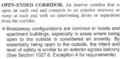

Yes, you copied the commentary. I have access to that. The "Open ended corridor" and the "non-rated corridor" open to an intermediate space are not the same thing (rated corridors can't be to intermediately spaces (with a few exceptions for foyers, etc.). Not sure what the point was?
sorry missed that.
