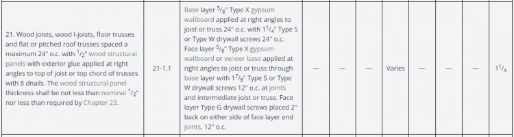

Ahh, you are looking at a floor-ceiling assembly then.
Table 722.6.2(2) will provide 10-min for wood floor and roof joists 16-in o.c.. But given that you have trusses, that is of no direct use.
Given the use of trusses, you will instead need to use a prescriptive or tested assembly. Prescriptive assemblies can be found in Table 721.1(3); take a look at item number 21-1.1 below. Or, if you would like to go with a listed assembly, use the UL Product iQ or GA 600 Design Manual.
FYI - Note that the IBC does not have 30-min prescriptive assemblies.

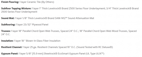

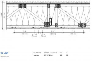

I did see Table 731.1(3) but it seems to not include open web trusses. I was thinking I needed to find a listed assemble. I previously found an open web truss 1-hour assembly below, but it also includes an STC rating which I don't think this project will require. I could not find a 1/2-hour assembly. Maybe such an assembly doesn't exist. It might be time for me to have a discussion with the building official.

Check to see if the bearing wall now need to have a rating as they are supporting the rated ceiling floor above
You answered my question about walls in your 1st response, thank you.
Thank you for your responses. View attachment 11944View attachment 11946
Don't you need sound separation between dwelling units (as this listing shows)?
