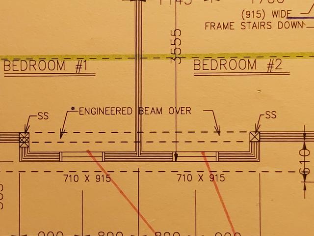

    I have come across a couple more abbreviations:
    SS [​IMG]
    PL wall [​IMG]
    PD [​IMG] [​IMG]

    SS ... structural steel? Or a tag that refers back to a column schedule.
    PL ... plumbing?
    PD ... window designation code. Similar to SS.

    what are the numbers then a X then numbers, never seen that

    Size of opening in mm. I'm assuming this is a government project, so metric must be used.
    As far as the abbreviations go...I'm at a loss for most of them.

    PD -Patio door
    PL - Plumbing wall
    SS - Staggered Studs or Stud Supports?
