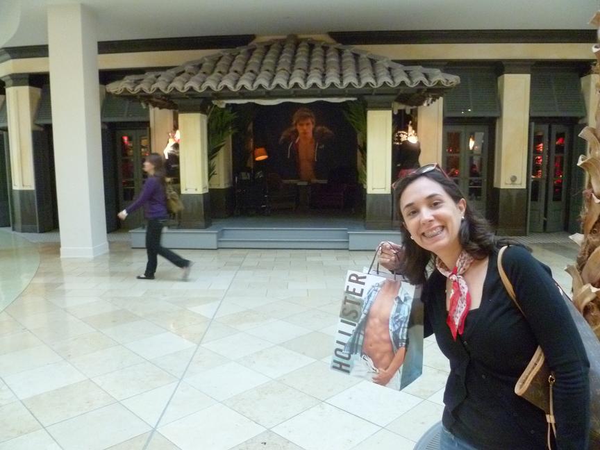

mark handler said:
I do not have all the facts, it looks like a display window to me.There is no visible signage directing a disabled user to that door.
I might accept it if there were signage inside and out and if i arrived in the same space inside, as the main door. But only if the building were existing. I would prefer seeing a ramp leading to the platform so that the disabled could enter through the same doors. Truly equal access.
I can accept that. Seems reasonable.
Noncompling Double door
Hollister has argued that it complies with the law because the stores include side doors disguised as shuttered windows that are wheelchair accessible. Plaintiffs say those doors often are blocked with tables stacked with merchandise.
Two newer stores, in Aurora and at Flatiron Crossing, are wheelchair accessible.

and that the entrances violated both the spirit and letter of the law
I would disagree since the accessible entrance was in the area it meant the intent of the law (to provide access in the same area) The blocking the entrance with clothes and other merchandise. I agree guilty.

As stated in several posts above, poor design does not necessarily equal Code violation.
The Codes have been written in a way that allows such a design, provided an accessible entrance is nearby. You even state "(I) thought it was quite clever"
If the accessible entrance is provided as permitted in the Code, the architects and BO's can/shall approve it.
If they had 3 entrances at the front of this store and the center one was not accessible and the other 2 where would that be a violation of the ADA. Please provide a specific section that clarifies which doors have to be accessible and which do not. I do not see anything in the ADA that mentions a "main entrance" they just talk about entrances.
mjesse said:
As stated in several posts above, poor design does not necessarily equal Code violation.The Codes have been written in a way that allows such a design, provided an accessible entrance is nearby. You even state "(I) thought it was quite clever"

We very clearly disagree, and I can see your point completely. But I would have to allow the A&F entry if submitted, BECAUSE IT MEETS CODE.
In your opinion, but as the court pointed out, you would be wrong.
That case, A&F, discriminated.
Side and rear entries might be okay in existing buildings but not in new building or as a company policy
Learn from the mistakes of others.
The lack of signage directing those in wheelchairs to the other entrance effectively prevents them from using it: You can't see the button unless you know it's there and know what to look for.
The alternative entrance was either locked or was impossible to use because of displays.
