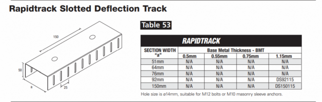

Truss clips are used to secure the top of partition walls. Truss clips allow the bottom chord of the truss to secure the wall with no bearing. How much a truss flexes is not something I know about. I would expect a fierce wind to have a slight effect as well as moisture content variations in the wood.
The truss bottom chord will bow up...Typically when the drywall stops at the non-bearing wall you put your first screw back a foot or so, so that the ceiling drywall sags and stays with the wall drywall and doesn't rip apart the tape joint....Not an issue at bearing walls...YMMVVWP
Where does this practice/requirement come from? I have always seen people just shoot a couple of nails through the top plate to hold the top of the wall in place... Everyone here does that, and I had never questioned it.

This is common with steel stud framing on commercial applications. I have not seen this used on residential applications. It would certainly perform okay. However, the bulge it creates would need to be addressed.
