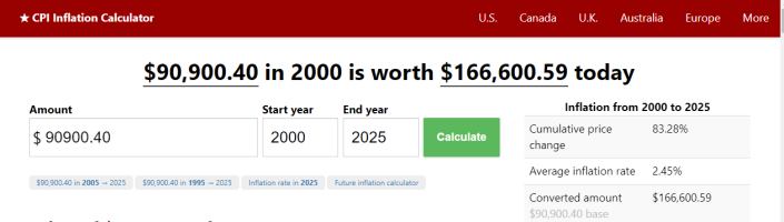

The 2025 valuation threshold is $203,611.00
Interesting to see the valuation through the years: https://www.dgs.ca.gov/DSA/Resource...rials?utm_medium=email&utm_source=govdelivery
In 2000, it was $90,900.40.
25 years later, it is $203,611.00, 224% increase in 25 years.
Meanwhile, the Consumer Price Index has risen 83.28% during that same period.
https://www.in2013dollars.com/us/inflation/2000?amount=90900.40
It serves to show how volatile our construction market is in California.
Interesting that the increase was fairly linear and consistent -- until COVID.
