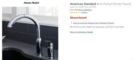

There are faucets where the nozzle sets into a rigid sleeve that enables it to function with the push of a button, no grasping required:
There are other nozzles that do not retract into a rigid, but instead permanently dangle down. These are loose, and require grasping in order for the button to depress. Is it "tight" grasping? I don't know. But if I had no opposable digits, I couldn't change the spray control:
Even with this you still might need to grip it. Here’s the kitchen faucet with a pull-out sprayer I have at home:
There’s a black button on each side, it runs through the width of the sprayer so when one side is pushed it pushes the other side out. Buttons are relatively large and easy to push, but the trick is that you have to hold the faucet in place by gripping it between your thumb and fingers, otherwise when you try to push one of the buttons it rotates the neck of the faucet instead of pushing the button in. So if you want to eliminate any grasping you keep pushing until it reaches the limit of travel. Having used this faucet for years I would say it is not accessible because sometimes it requires tight grasping to pull it out because of a design flaw where the O-rings around the base of the sprayer sometimes roll out of their tracks a little and it binds and you have to pull much harder to remove it.
Good question. No grasping is required to point it at an angle, but it’s definitely going to flex when you try to push the button so you have to grasp it enough to prevent it from moving. If we’re allowed up to 5 pounds force for an operable part then 5 pounds would be the limit for “tight” grasping I would think, otherwise “tight” is a little subjective.
