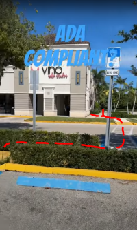

Accessible Parking or Not?
I don't see that as being compliant for several reasons. The 1st as you pointed out that should be over next to the curb of the building instead of where they are. The 2nd is because they don't have the Req spacing for a ramp van to put the ramp down.

It's a bit of a judgment call but IMHO it's clear that those two spaces are not as close to the building as they could be, so it's a violation.

I agree the video depicts a non-compliant parking accessible space
