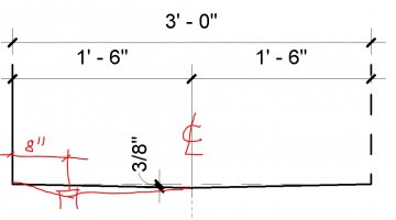

I cannot seem to find a definitive answer to "is there a specific location required for the shower drain?" All of the CBC diagrams show the drain as centered in the floor of the shower area. The 2001 CBC had a little blurb for the drain location being "within 6" from the rear wall" of the enclosure. This was for a "accessible dwelling unit" and a 42"x48" shower.
Is there any code reference regarding the actual location of the drain? floor surface to be 2% max slope in any direction. We will be specifying a floor drain in the area outside of the shower as well. any drain location requirements for this area?

The ADA figures for the typical 3' x 3' shower compartment don't address the drain location with respect to slope,(or I am missing it). Centering the drain results in only a 3/8" drop to the drain if you adhere to 1/4" per foot slope. If you move the drains to the back, the drain drops, but the slope to the back wall exceeds the 1/4" per foot. These showers must overflow frequently!

If you move the drains to the back, there is nothing that says the slope at the back wall must exceed 1/4" per foot.
You can keep it at 1/4" per foot for that 8" run - - it just means that you won't have a uniformly level elevation of the transition from the floor to the wall.
