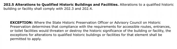

Am I correct ... when 2012 IEBC B.408.1 says the provisions of this code shall not be mandatory for historic buildings ... that does not overrule ADA requirements.
ADA has a historic exemption clause, but certain criteria have to be met. My archy says we don’t have to comply because of iebc, I’m saying we have to follow ADA.
Am I correct
Yes, sorta'.
The ADA rules, and supersedes any other codes.
BUT, you can't enforce it by itself - all you can do is enforce the codes your jurisdiction has adopted and/or your State has empowered you to enforce.
Ok, thats what i thought. The situation is not a typical code issue, its all about accessibility. The architect is saying we don’t have to comply because its a historical building and iebc has an exception, i am saying ada overrules.
Full disclosure: i would really like to find an exception that obviates the need to make the changes, but I don’t think there is one. I think the archy is taking the easy way out, and in the end it’s not going to fly, so let’s address it up front.
The historic building exception is a specific process, not affected by local code. It requires consultation with the appropriate historic advisory board or officer designated in the Standards.

Difference between a code and a Civil Rights law, maybe your architect needs to take a class on the requirements.
A registered landmark building may have some ADA requirements relaxed, but it still must be accessible to the greatest degree possible without threatening the historic integrity of the building.
See Virginia Existing Building Code section 405.
Virginia has almost completely rewritten the IEBC, so don't use the unamended IEBC.

IEBC 705.2, and ADAS 202 for "additions and alterations" apply when the building is altered. The alterations themselves must have accessible features, the 20% rule applies for other prioritized components, and the concept of "technically infeasible" comes into play for the owner and plan checker to evaluate. "Technically infeasible will take into account structural implications, and for a historic building, character-defining features.
When the building is not undergoing addition or alteration, ADAS still applies, but a different concept comes into play: "readily achievable" comes into play. "Readily achievable" includes a stated listed of low-hanging fruit, such as adding grab bars.
