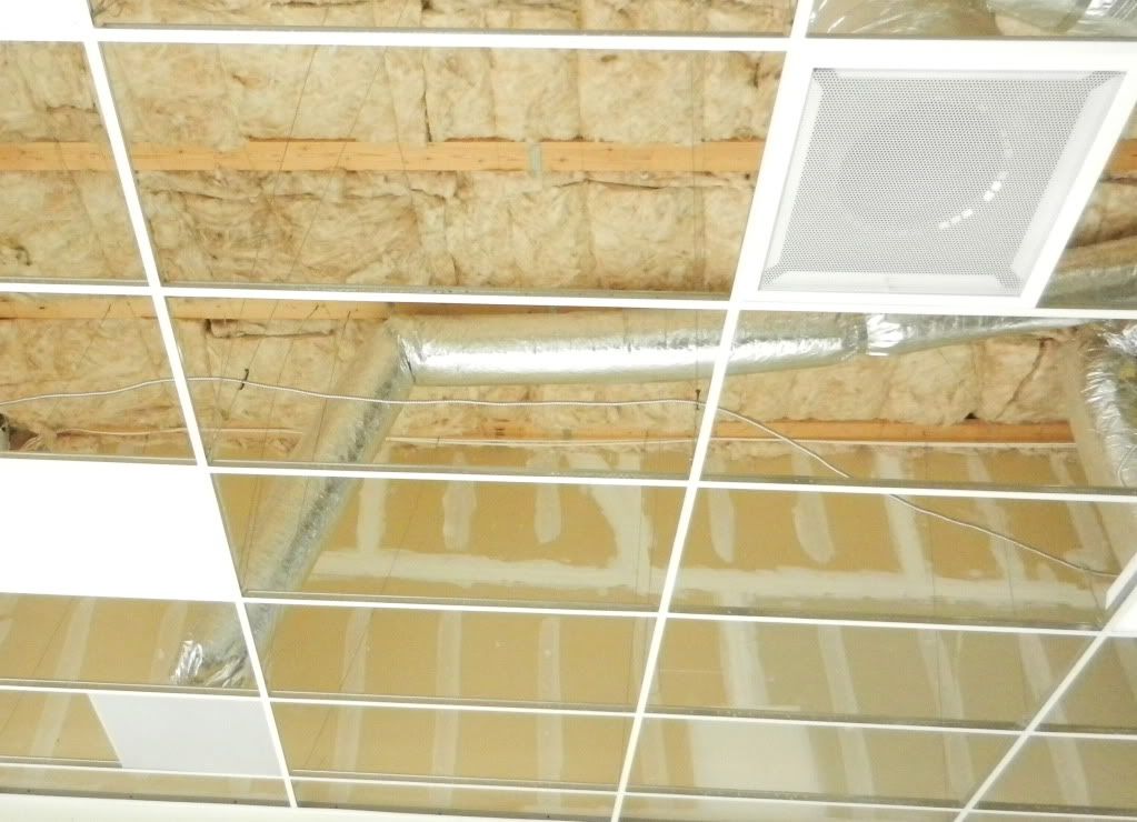

I pointed out that the duct has collapsed at the bend. The contractor kept asking me what radius is required by the code.

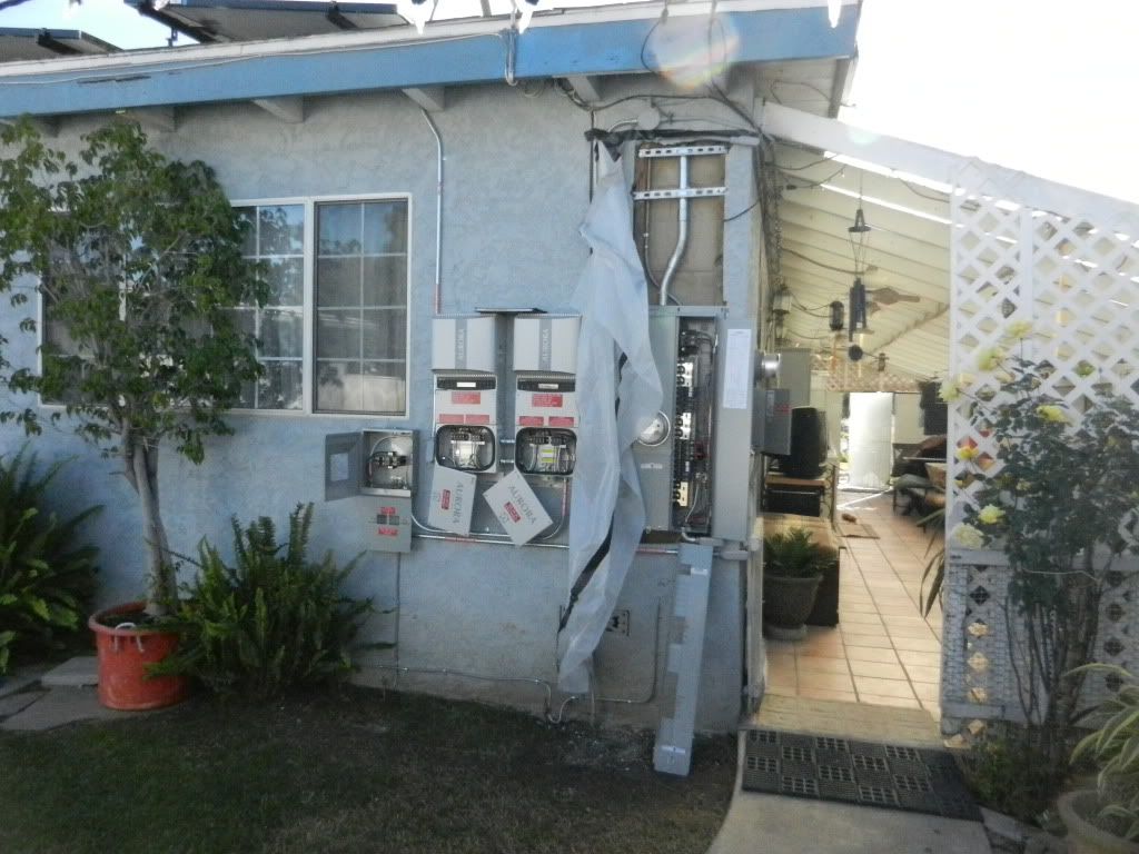

The service panel was installed four years ago without a permit. Edison decided that they were going to shut it off if they didn't get an inspection by me. To prepare for that inspection, they installed a pair of ground rods and a bonding jumper to a water pipe. I wonder what got Edison so excited.

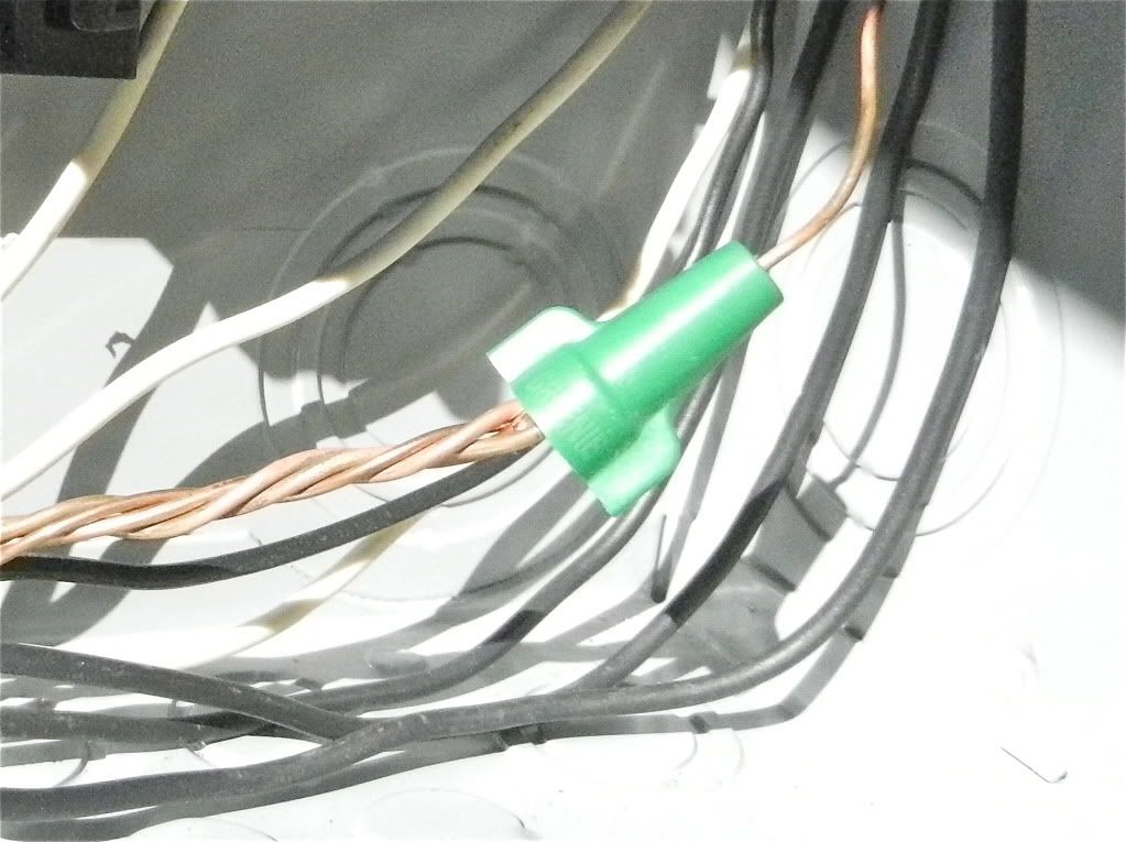

#561

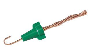

It is that the lock rings are not tight. A lock ring should bite into the metal. There are variations of the defect such as crooked conduit and rings that are upside down or too small for the hole.
It should look like this.

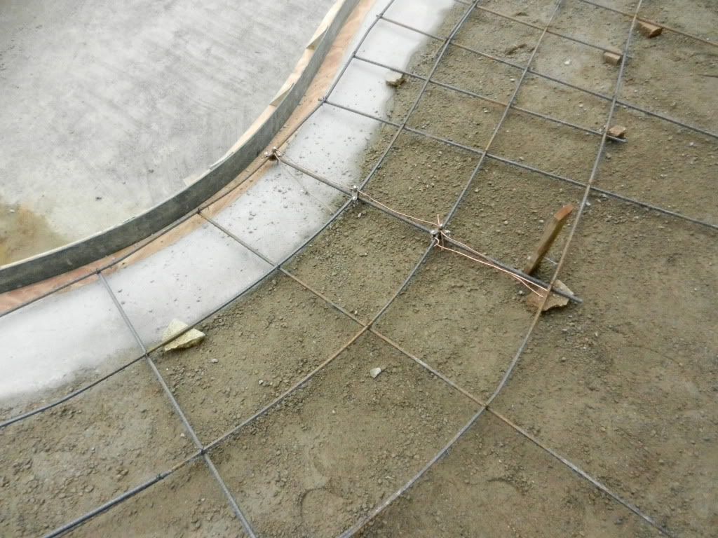

#562
The The plumbing that you see there is process pipe. As such, I do not inspect it other than in the shell of the pool. Pool contractors don't know that and always call for an inspection of the pipe before they backfill trenches. And yes, they always have 20 psi air pressure. Pool contractors make me nervous. Pool contractors are to all the building trades as solar contractors are to the electrical trade.

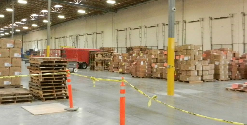

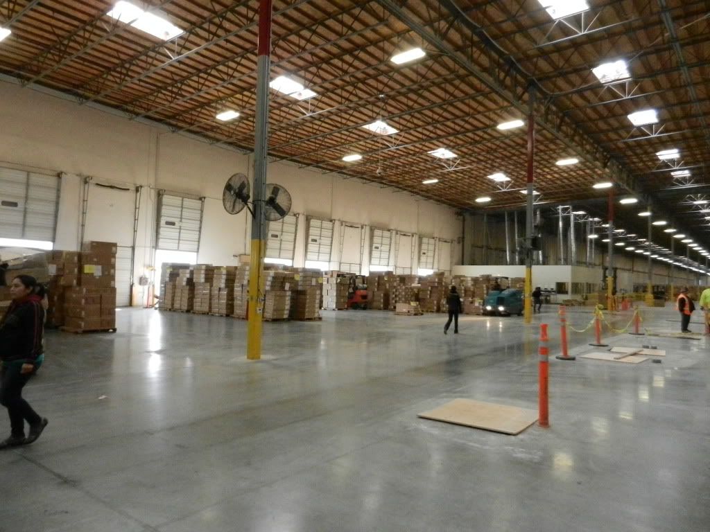

The building is 800K sq.ft. A mezzanine of 90Ksq.ft. is being built. There are column footings galore.
The footings adjacent to the K brace have been dug.
Visible in the first hole is a portion of the block of concrete that secures the brace.
The plan show 8" dowels with 4" exposed at all of the footings. The dowels are a slip fit.
In the past, I have inspected K brace footings that also had special reinforcement in the slab around the brace footings. I asked that question and nobody had an answer. Three days later, their engineer came to the office to confer with our engineer. The conclusion is that this K brace did not require slab reinforcement, and it never hurts to ask.

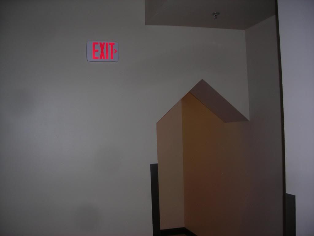

The building is over a quarter mile long. There are exit doors with exit signs directly over the doors. The doors and signs are hidden by product. A mezzanine is being built so before it's done, I will get exit signs placed where they can be seen.
I wonder what the Fire Dept. has to say about this.

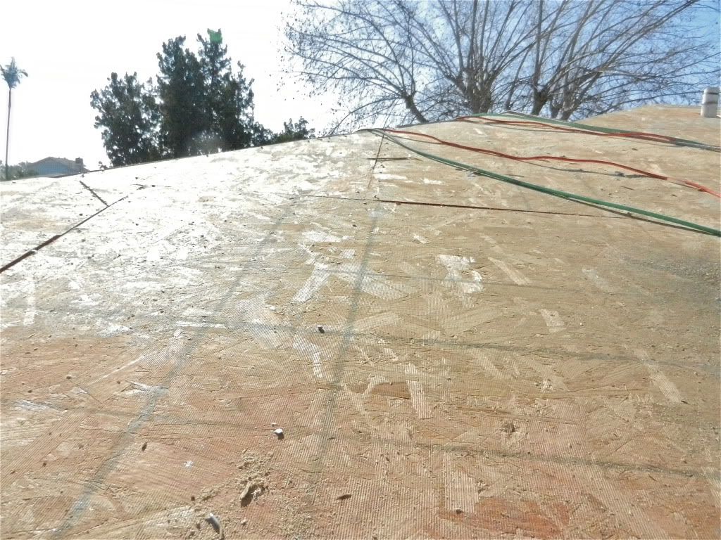

Three guys showed up at the counter this morning. One did the talking. He explained that he was the contractor doing a re-roof that was up for inspection today. His question was what is the nail pattern for sheathing. He wanted to make sure that they got it right because "Every city is different"
The ladder was too short....there's sawdust on a steep roof....and nails sticking out of the roof, everywhere.
