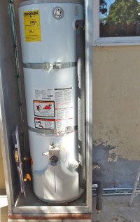

It was left open and energized....waiting for inspection.
I removed half of the company's name because we aren't supposed to identify anyone....I can tell that it rhymes with ti***....darn it, I can't say that either.
They insulated the T&P drain pipe.....because they just did a similar job in the city of Norwalk and they are quite certain that the Norwalk inspector insisted that they do this.
So I wonder if anybody else requires this and if so, why?

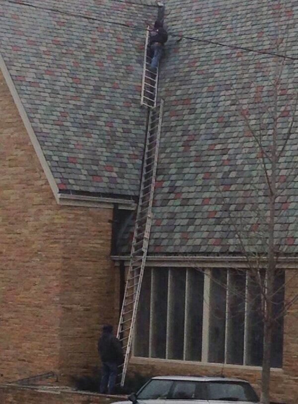

I used to spot for a crane. Sometimes there was only one way to reach a perch where I could see the operator and the load. I would straddle the headache ball and get a ride. Getting off was easy, getting back on could be scary.
fatboy said:
Yeah, I shudder when I think of some of the means I used to get elevated to do the work...........

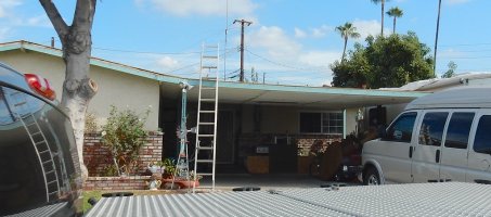

I took on a job cleaning an exhaust system on a 2 story hotel. I did not know it was built with 12 foot ceilings on the first floor and 10 foot ceilings on the 2nd floor. My ladder is not that tall, and I do not have a way to transport a ladder that tall. The customer parked his pickup on the sidewalk, I extended his ladder full length. I barely could reach the railing around the fan and pulled myself up to the work platform. I usually take the wand and hose with me, that day I took a rope with me. I had tied the rope on the wand and pulled the hose and wand up. I cleaned the fan and duct, and lowered my equipment to the ground. Usually I go down the ladder, change the pick-up tube to fresh water and return to the roof and rinse off the fan. Not that day, one trip was enough. After I got down, I looked at the grease I blasted off the fan, it landed on his freshly primered pick-up. Two boys were washing cars across the street. I gave them $5.00 bucks and told them to do their best. They got some grease off.
About 5 years and 2 or 3 owners later, I got a phone call to fix the fan. I declined.
The drop is long.

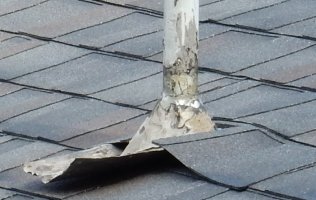

I received a call from a solar contractor. He wanted to know at what stage do we require a rough inspection. I explained that the inspection should take place after everything but the panels is installed. That's when he described the mounting feet. He told me that according to the approved plans there is a three part system of mesh and tar that seals the roof. i told him to use a tar that will harden and sprinkle granules into the tar before it sets up.
That tar will never become solid....that's a good thing
