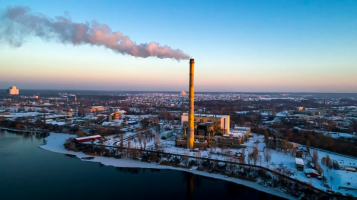

This is what the code is thinking when it puts refuse incinerator as a occupancy. I'd consider animal crematory as a B. It would not be constantly used but a few times a week at most unlike refuse incineration. Id assume that the code developers were aware that cremating animals is a standard practice in many vets.1715194084976.png
