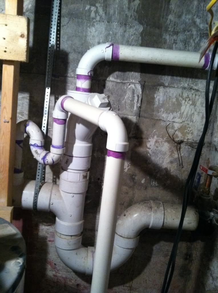

Another clueless plumbing job in a commercial building
Forum Coordinator
11,113
Somewhere Too Hot & Humid
Who needs a fresh air intake anyway for that building trap, not to mention, what the hell is this mess?
Looks like:
1. "We trapped the sewage ejector because [insert long explanation here, substantiating with fictional scenarios]"
2. "There was no fresh air intake before, so [insert another long diatribe]"
Or did they cut off the fresh air intake and connect the ejector to it?
