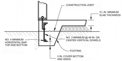

Here’s where I stand - I have a 30x26 pad that is 3.5” thick and directly on grade. I thought this was fine due to the minimums in the IBC but then learned about the IRC and the rules there. I have a non-refundable deposit of $1300 down for a 30x26 metal garage. I do not have any footers poured for this.
What are my options? I’ve only been able to come to two conclusions and hope that maybe they’re acceptable as far as code is concerned.
Option 1) My preferred option would be to cut a 1 foot section off the 3 load bearing edges of the slab. Dig a trench for the footers and pour them to be level with the slab. Would an expansion joint be needed in between the footers and the slab? I think so but I’m not 100% sure.
Option 2) Eat the $1300 deposit and have a “pole” garage built around the slab I’ve already poured.
None of it has to be pretty, I just wanted to get my vehicles off my driveway, grass, and under something for protection. If I took the “walls” off the garage would it change anything about my situation? Thanks for any help and additional ideas. I’m just trying to get a jump on this before next week starts.

Cutting the perimeter off the slab and pouring a new proper foundation would be a good option. It’s no different than poring the foundation first, erecting the building, and pouring the slab later ... except your doing it in reverse.
IRC Section R309.1 requires the floor area used for parking automobiles to be sloped to drain toward the main vehicle entrance. That could be an obstacle to getting the building permitted with the existing slab.
The slab could have an adequate footing underpinned. I have encountered dozens of the same scenario. Cutting the perimeter and digging a footing would be easier and a cold joint is acceptable. A 30'x26' is a shop building and a shop building does not require a sloping floor. Even if it were permitted as a garage, I for one would not ask you to do the slab over Just for slope.
Now there are questions as to what reinforcement was used in the slab and what evidence could you provide? Did you place anchors for the walls?

The lack of reinforcing in your slab will cause you problems. Concrete shrinks as it dries over time. Without reinforcing these cracks will get worse as you drive vehicles on the slab.

Or drill holes on the outside of the slab, set the posts and build the building. There's no way I'd tear out the slab (or make someone tear it out as the B.O.) if a pole building is what's going over the top of it.

It might be possible to cut a couple feet off 2 sides of the slab, then pour a new slab with turned down edges on top of it, so the garage is offset a foot or 2 from the present slab location.
Reinforcement in a garage residential is mostly to minimize cracking. Fibers mixed into the concrete are another way to do this.
Cut it back a foot all the way around. Pour new footing four inches higher than slab every where except where the roll up door is and put building on top of footing.
Yes will need expansion joint between slab and new footing.
