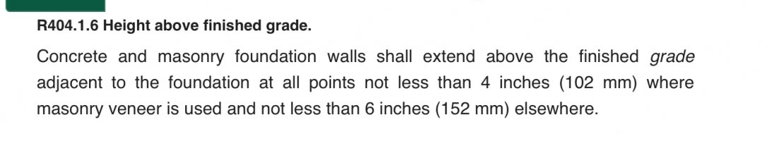

Concrete floor 6 inches above adjacent grade. Slope 6 inches down from there, within the adjacent 10 feet. Code sections attached.

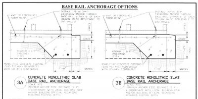

I’ve attached the anchoring and foundation recommendations from the building plans.

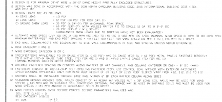

Sorry I meant to add you to the post above. Please give me any information to look for and I'd gladly give it to you. Their website doesn't have very much information but I do have access to the generic plans. I attached the foundation suggestions from the build plan above. I added a quick overview from the order form if that helps at all. I figured the snow load and wind rating may be helpful.

I see no mention as to Foundation requirements?
What I posted is all that the building plans offer.

The anchorage drawing you posted makes it look the exterior wall is a bearing wall with studs. If so, you can use these tables.
A lot of metal buildings have columns & frames 10 feet or more apart. That creates a concentrated load which requires larger footings under the columns, which will probably require engineering.
In my experience with metal building company plans, the foundation is always engineered by others. In my youth I worked for Morton Buildings. We stuck creosote poles in the ground and called it good. By now they probably have to provide an engineer's stamped plan....for a pole stuck in the ground. Come to think of it, I do not recall having plans for the barns. We certainly did not get inspections and some of the barns were huge.

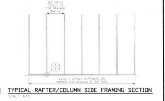

This is all I have for spacing on the posts. Doing some research from another manufacturer and they say the end posts are typically spaced 4-5 feet apart depending on wind certification and snow load.
Edit: I was able to find what the structure looks like per the company I have a deposit with. I’m not sure how accurate this is but given that the length of the sides are 25’ and it has 6 posts - I’d assume that it’s 4’ of spacing between the posts once you account for post thickness.

A1): Yes, the plans I’ve been referencing and sharing are stamped by a PE and approved up and down the east coast. From New York and Massachusetts all the way to Georgia and South Carolina.
A2 & 3): The only thing they’ve provided in regards to the foundation is what I’ve already posted. A slab on grade with turned down footings is what is shown in the screenshots I took.
