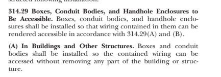

The NEC generally requires newer wiring to be spliced in a junction box and the wiring in the box to be accessible without the need to remove part of the building or structure (see 300.15 and 314.29). Section 300.15(H) refers to Section 334.40(B) when splicing nonmetallic sheathed cable (NM, NMC, NMS) and allows a special insulated device to be used instead of a splice box.
If you're disagreeing with my interpretation, I wish you would explain the words and in particular the change from 2011 to 2014.

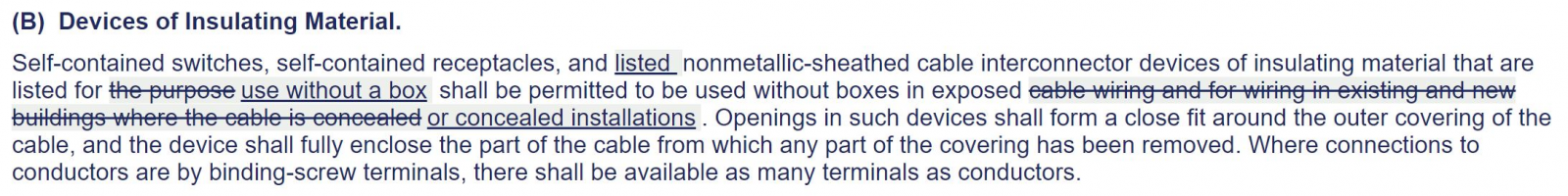

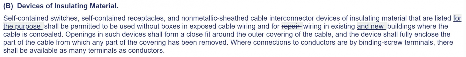

Well steveray, the code making panel must have read your mind - at last. Here are the first and second drafts of the changes to the 2020 edition for 2023 edition. Looks like - under 2023 - you can use them in new and existing, exposed, concealed, or to be concealed.
1st draft:
2nd draft (as should be published in 2023 edition):
