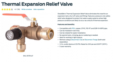

Expansion control is required regardless of the size of the storage water heater. An expansion tank is ONE METHOD, there is more than one way to accomplish this. Almost every structure in the US has a backflow preventer at the water service or at least a check valve at the well tank/pump system. If you can't fit a tank, there are approved valves used in many jurisdictions.
Just to be clear though, a standard TPR valve on a water heater is not an approved method.
