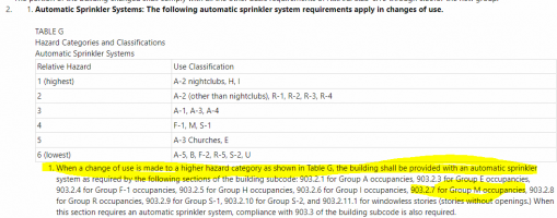

      1. Automatic Sprinkler Systems: The following automatic sprinkler system requirements apply in changes of use.
        TABLE G
        Hazard Categories and Classifications
        Relative HazardUse Classification
        1 (highest)A-2 nightclubs, H, I
        2A-2 (other than nightclubs), R-1, R-2, R-3, R-4
        3A-1, A-3, A-4
        4F-1, M, S-1
        5A-3 Churches, E
        6 (lowest)A-5, B, F-2, R-5, S-2, U
        1. When a change of use is made to a higher hazard category as shown in Table G, the building shall be provided with an automatic sprinkler system as required by the following sections of the building subcode: 903.2.1 for Group A occupancies, 903.2.3 for Group E occupancies, 903.2.4 for Group F-1 occupancies, 903.2.5 for Group H occupancies, 903.2.6 for Group I occupancies, 903.2.7 for Group M occupancies, 903.2.8 for Group R occupancies, 903.2.9 for Group S-1, 903.2.10 for Group S-2, and 903.2.11.1 for windowless stories (stories without openings.) When this section requires an automatic sprinkler system, compliance with 903.3 of the building subcode is also required.
          • When a portion of a building is changed to a higher hazard category and the proposed use is separated from the existing use(s) by a fire barrier or horizontal assembly, or both, having a fire resistance rating in accordance with Table 707.3.10 of the building subcode, an automatic sprinkler system as required above shall be installed only in the portion changed; mixed occupancies shall use the highest applicable rating from Table 707.3.10.
          • Fire Alarm and Detection Systems: When a change of use is made to any of the following groups, a fire alarm system and/or an automatic fire detection system shall be installed in accordance with Section 907 of the building subcode. Where a portion of a building is changed to any of the following groups, a fire alarm system and/or an automatic fire detection system shall be installed throughout the building in accordance with Section 907 of the building subcode unless the proposed use is separated from the other use(s) in the building by a fire barrier having a fire resistance rating in accordance with Table 707.3.10 of the building subcode in which case only the portion changed shall comply; mixed occupancies shall use the highest applicable rating from Table 707.3.10. (For purposes of applying this section, horizontal separation shall not be considered.)
          • Group M: A manual fire alarm system shall be installed and maintained as required by Section 907.2.7 of the building subcode.

I visited the store site yesterday and the store is in a big strip mall. The store has sprinklers installed. Two of the demising walls (side and back) are connected with traders joe and one of the side wall is connected with Nail salon. I guess i don't have to worry about fire rating of demising walls. the store has one ADA restroom, a small office area, a small storage area having water heater and electrical panel. the store has only one exit which I think will work because i will have occupant load less than 49.
