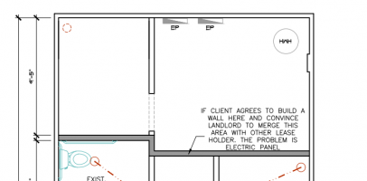

I am looking for some input. As per table 1006.2.1, Egress travel distance for Mercantile occupancy with sprinkler system is 75'. Am I reading it right or there is something more to this?
Please see attached plan of a M occupancy . It was a salon before. The depth is 74'. The calculated occupant load is 21 person, has one exit and egress travel distance comes out 98' which does not satisfy 75' requirement. this does not feel right because mostly retail/ Mercantile stores are deeper than 75'. Am i missing something?
Is counter location ok or has conflict with egress?

Yup, you sure do have an issue there. A second exit is absolutely needed.

Your exits must be separated. You would likely need to place the second exit on the rear wall given that it appears you have other tenant spaces on each side.
2021 IBC 1007.1.1 Two Exits or Exit Access Doorways
Where two exits, exit access doorways, exit access stairways or ramps, or any combination thereof, are required from any portion of the exit access, they shall be placed a distance apart equal to not less than one-half of the length of the maximum overall diagonal dimension of the building or area to be served measured in a straight line between them. Interlocking or scissor stairways shall be counted as one exit stairway.

You don't have many options. If you cannot add an exit, then you will need to pick an occupancy that allows for a maximum common path of egress of 100-ft or more.
Basically, you are limited to one of the following:
  • Group B or S w/ OL of 30 or less
  • Group B or S with fire sprinklers
Other than that, the design of the proposed tenant space is severely limited. The existing salon must have either had sprinklers or had an OL of 30 or less.

It seems there is no way to use this store as M occupancy. The store will have furniture displayed and AHJ won't accept it as B or S occupancy.
Let me know if you can think of any other way.
I can think of one way but not sure client is going to agree with this. Reduce the depth of store by extending restroom partition to the full width of store.

I do not follow how you would change the location of the most remote point. It does not matter what the use of the room is, you measure from the most remote point in every room; although, it is typical to only show the room with the most extreme.
This is what I am thinking about. Please see attached.

I have a couple of comments. First, you are not measuring the exit travel distance correctly. Both the IBC Commentary and the NFPA 101 Handbook tell us that the path of egress travel is to be measured along rectilinear axes, not along the diagonal, because when there is "stuff" is rooms and spaces, people have to maneuver around the stuff.
Second, why does your exit path go out a single door to the side when it would be shorter to go straight out the double doors at the center of the facade?
Third: You can't resolve the issue by putting toilet rooms across the back, because the exit access will still begin at the most remote corner of the overall tenant space. From the IBC definition of Exit Access:
The exit access portion of the means of egress consists

A toilet room is certainly a "usable space," even when not counted toward calculating the occupant load in occupancies where the occupant load is based on the net square foot area. The commentary makes it clear that only spaces where people ordinarily won't ever go are excluded from being part of the path of egress travel.
Why can't there be an exit door out the back? Is this tenant space in a mall? Most mall stores have a door to a service corridor in the back.
This is an existing building. If you can't add an exit somewhere near the rear, then there are only two options:
(1) Apply to the AHJ for a modification. In my state, that's only done though the state. I don't know if the local BO has that authority in New Jersey. Usually, modifications are granted if the applicant offers up something to help achieve equivalent safety, so a possible trade-off for a non-compliant exit access distance might be additional smoke detectors in the spaces at the rear of the store.
(2) The tenant walks away and finds another space to rent, where they can have their mercantile occupancy and comply with the code requirements for Use Group M.

You can't have the electric panels for one tenant located in another tenant's space. And the water heater is in that space, too. That doesn't work.
And you are still drawing the exit access path along diagonals. It has to be rectilinear.
