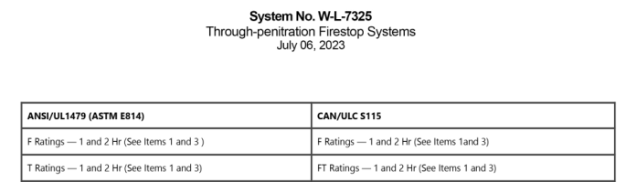

I am with sales for Fire Shield. Recently we have had multiple projects across the country call us after failing inspection. The common industry practice of a "5 sided drywall" method requires EJ's and increased cost on labor and material. More inspectors are cracking down on this not being a viable solution. Has anyone ran into this issue on job sites? Our product is UL tested and listed and is the only system available that is approved for back-to-back configurations. Thank you for your input!

Can you provide a link to the UL website for their listed assembly that is cited in your literature, W-L-7325?

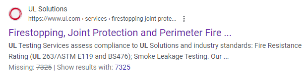

When I do a search on UL, your product does not show up.
They are creating a membrane penetration in a firewall with their five sided box, which needs to be protected with a listed system per 714.4.2 of the IBC, and the five-sided box is not a listed system that I have ever found, and no one has verified that it is compatible for all of the different wall systems it is installed in.
If a contractor can't show me their listed wall assembly and a listed membrane penetration system that works with that wall, I would not accept it.
