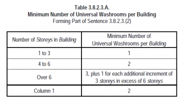

This is from Ontario Building Code:
3.8.2.3. Washrooms Required to be Barrier-Free (See Appendix A.)
(1) A barrier-free path of travel shall be provided to barrier-free washrooms designed to accommodate persons with
disabilities in conformance with the requirements in Articles 3.8.3.8. to 3.8.3.12.
(2) The number of universal washrooms conforming to Article 3.8.3.12. provided in a building in which a washroom is
required by Subsection 3.7.4. shall conform to Table 3.8.2.3.A. (See Appendix A.)

Questions:
1. Does the above table require the universal washroom shall be in the public area of the building?
2. In a doctor office building, is every suite of the doctor office required to have universal washroom? (Assume the building is required to have barrier-free path of travel)

1) For the most part. The only exception would be where there is no public washrooms, then no barrier free washroom accessible to the public would be required either.
2) See sentence 5 of this clause for exceptions.
Yes, it is likely that the individual spaces could use a common barrier free washroom to meet the requirements of the code.
