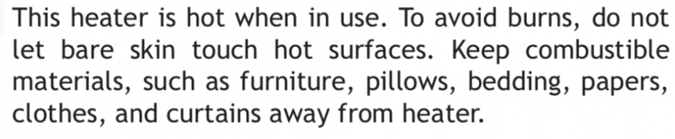

This is from installation instructions:
The large font is because I couldn’t copy and paste so I did a screen shot.
Bare feet and towel racks could be an issue. There was no mention of a bathroom or a damp/wet location.
