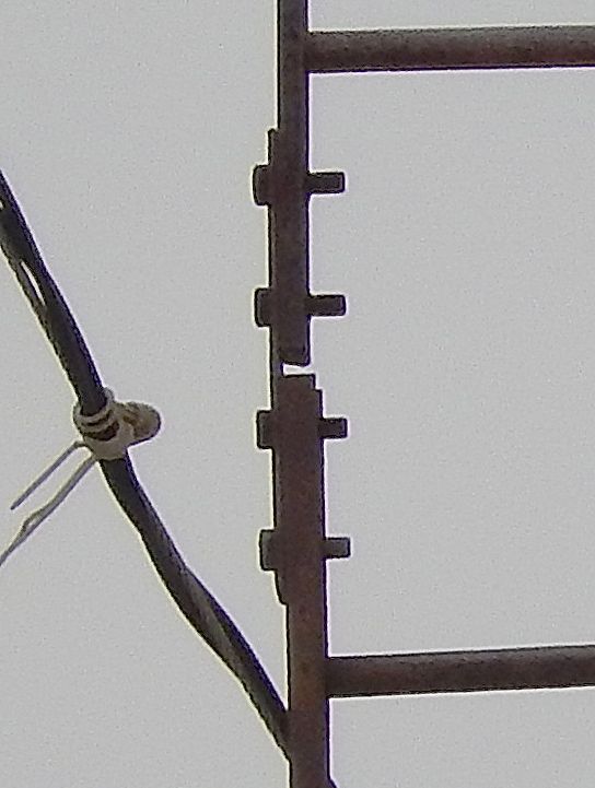

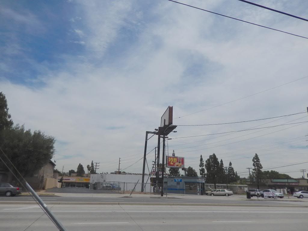

bill board cat walk
From a regulatory perspective what the Townships insurance requires is irrelevant. All you can enforce are legally adopted ordinances.
These signs never have guard rails.
Nothing dangerous about it.
Well unless you take a close look at the splice in the ladder. This ⬇ picture was taken from the same spot as that ⬆ picture

Does anyone know a exception for guards on a billboard catwalk? The catwalk is 2' wide used to change the sign. 2009 IBC including appendix H.

SECTION 1012 GUARDS
1012.1 Where required.
Guards shall be located along open-sided walking surfaces, mezzanines, industrial equipment platforms,....
The facts as I see them are: Rick "needs" to sign off on the billboard, I think he has a legit concern, he has a few options. Pass it as is and plead the "it's not in the I-codes" to the Judge when someone gets hurt. Ask for safety documentation (procedures) from the sign company, if satisfied, sign off. Or have them install a guard per IBC requirements....
Hoping I never have to approve one.....
If you can use Appendix H....this might get you there....
SECTION H105 DESIGN AND CONSTRUCTION
H105.1 General requirements.
Signs shall be designed and constructed to comply with the provisions of this code for use of materials, loads and stresses.
Then all you are looking at is the engineering....However you handle that in your J....
Something like this...
