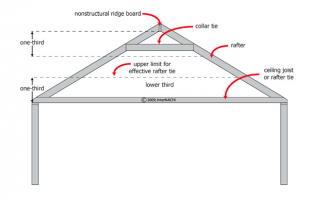

You are confusing a ridge beam with a ridge board. With a structural ridge beam there are only vertical forces on the rafter.
All I am thinking was that this was a very small project and is it really that difficult to cut a couple birds mouths into the 6-10 rafters?
The use of that image of the beveled strip is kaka IMHO.
