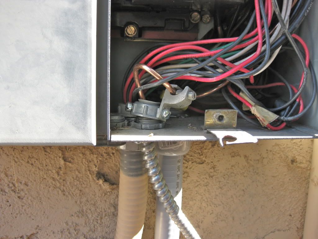

Should the lock ring be removed before the bonding bushing is threaded on?
If the nut is not removed,
1. Where do you get a nut to secure the connector to the box?
2. When you do find another nut, there will not be enough threads to securly tighten the fitting to the box.
Now, can I have my wire strippers?
Gregg Harris said:
I do believe it requires a lock ring on both sides.
This is a residential service 120/240. I'm pretty sure that double lock rings don't come into play unless it is over 600 volts. But don't take my word for it, ask an electrician.
jar546 said:
Why is there a bonding bushing on that?
That is a grounding electrode conductor that has armor sheath protecting it. Every end of the armor shall be bonded to the GEC. Before this panel was done, there were four more bonding bushings, one for each conduit.
Sometimes it doesn't matter. If anyone can access the listing I would like to know about the lock ring. I guess I can go to Home Depot and see how they fit together.

The OP picture by ICE, Is it permitted to drill a hole anywhere in the box or are you suppose to use the knock-outs?
pc1
you can drill a hole in the top, sides or bottom, as long as you've got proper wire bending space, room for fitting and locknots, and grounding bushings if req'd

Just to be clear- this is a weather proof enclosure so entry above the busbar would not be compliant with this type cable since the connectors would not be able water tight.
I can't find the listing, yet here is some food for thought.
1) I researched 3 manufactures of bonding bushings all 3 state for use on RMC IMC. So again IMO the use of one on a MC fitting violates 110.3(B). Here is a link to one.
2) There is a sentence in 300.4 that would lead me to believe a metallic bonding bushing is not required to secure a raceway to an enclosure.
300.4(G) Insulated Fittings. Where raceways contain 4 AWG or larger insulated circuit conductors and these conductors enter a cabinet, box, enclosure, or raceway, the conductors shall be protected by a substantial fitting providing a smoothly rounded insulating surface, unless the conductors are separated from the fitting or raceway by substantial insulating material that is securely fastened in place.Exception: Where threaded hubs or bosses that are an integral part of a cabinet, box, enclosure, or raceway provide a smoothly rounded or flared entry for conductors.
Conduit bushings constructed wholly of insulating material shall not be used to secure a fitting or raceway. The insulating fitting or insulating material shall have a temperature rating not less than the insulation temperature rating of the installed conductors.
3) Again your regional use of 3/8 FMC for this install seems to be in violation of 348.20.

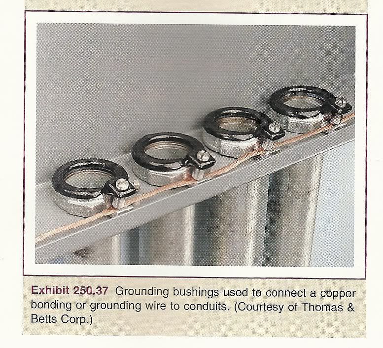

And in closing, the following pic is from the 2008 NECHB and is courtesy of a manufacturer of bonding bushings. No lock nut required.
[/QUOTE]
But using a locknut is also not a violation.

Thanks gentlemen,
I appreciate the time you have spent on this.
Our use of FMC to protect a GEC is becoming more suspect by the day. The use is widespread here in Ca.
The clamp in the picture has a listing and I wonder if this clamp was developed specifically for this application because I don't see any other use for it. I don't know what the listing says and as wrong as I've been in the past I won't be taking any bets.
Looking at the conduit fittings, I don't see enough threaded material to screw on a bushing unless the lock ring is removed.
ICE said:
Thanks gentlemen,I appreciate the time you have spent on this.

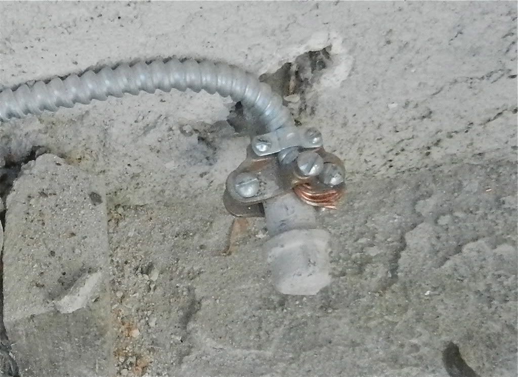

Galvin Electrical "The clamps are used to connect armored cable to water pipe for grounding."
UL and CSA listed
250.64
(B)
it shall be in rigid metal conduit, intermediate metal conduit, rigid nonmetallic conduit, electrical metallic tubing, or cable armor. Grounding electrode conductors smaller than 6 AWG shall be in rigid metal conduit, intermediate metal conduit, rigid nonmetallic conduit, electrical metallic tubing, or cable armor.
(E)
The bonding jumper for a grounding electrode conductor raceway or cable armor shall be the same size as, or larger than, the enclosed grounding electrode conductor. Where a raceway is used as protection for a grounding electrode conductor, the installation shall comply with the requirements of the appropriate raceway article.
Cable armor is not a raceway nor is it armored cable. It is an armored bare conductor made for pulling. I really should go by H/D and check the labels. It comes in a roll. Other than the requirement to bond every end to the GEC and secure it, all that's left is the listing, if there is one.
Gregg Harris said:
Galvin Electrical "The clamps are used to connect armored cable to water pipe for grounding."UL and CSA listed
Thank you-- I have never bonded with armored cable and it does not look like an armored cable connection. It looks like a nm cable type of clamp and generally they are not compliant for flex. I see that they are compliant.

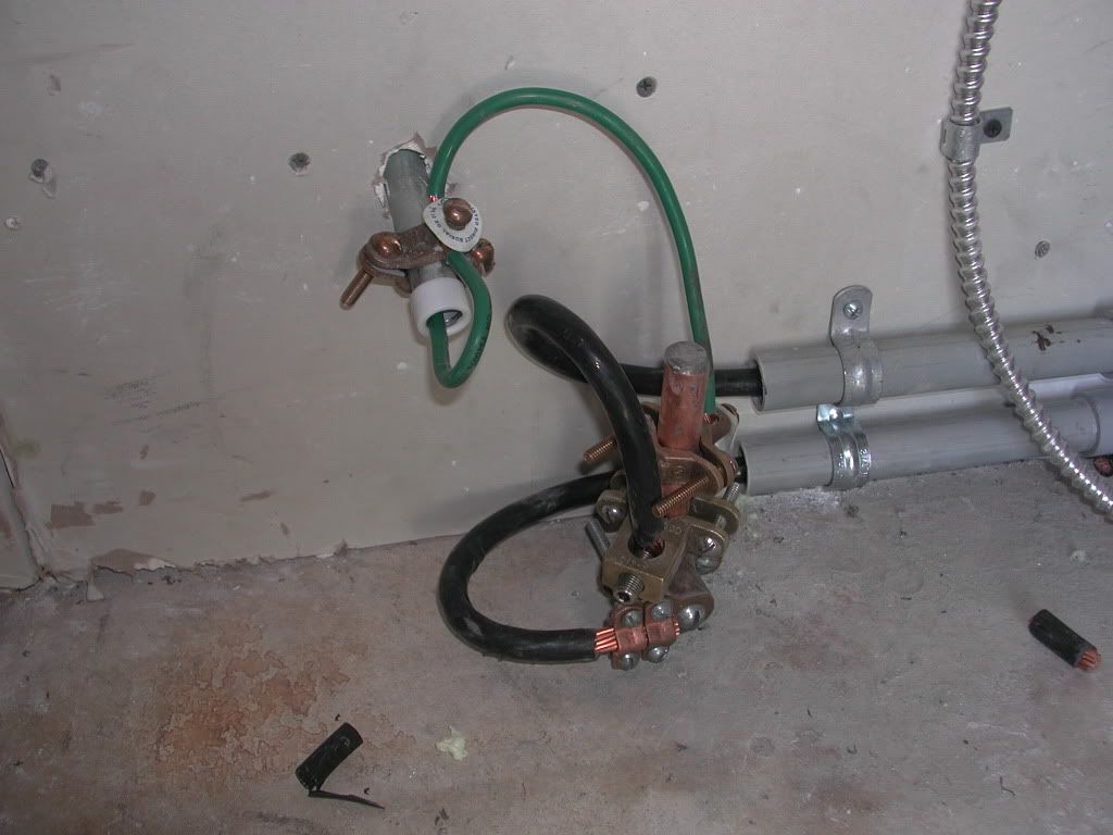

Typical east coast install done yesterday.
Maybe in Florida but not here. I have never seen a rod and gec installed like that. I assume you guys have to use copper because of the salt down there? I know I did when I did a house at the coast here in NC. PVC wasn't allowed outdoors there because of the sun. I installed a temp. pole with a pvc riser and I had to change it to galvinized.
Is there a reason that you use insulated as opposed to a bare conductor? Why are there two GEC? Is that schedule 80 conduit? What is the green bonding jumper for? And I see an armored cable, what's that for?
