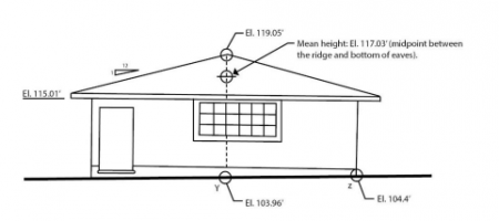

How do you measure the building height of an A-frame building? apex or half way between apex and average grade?
My planing department has consulted me to see if the BC building code offer any insight on how to measure the building height. Especially for A-frame. Would you consider the A-frame as roof or wall?

How we normally measure building height:
The building code measures height in storeys and refers to the height of the first floor above grade.
Zoning bylaws mean the actual height of the building, as in where the peak terminates vertically.
I do not think using the BCBC as a reference will help your planning dept measure a building height.
Our zoning bylaw measures height as 1/2 way between the peak and the eaves, for what its worth.

Also, the baseline for measuring building height may differ between building codes and zoning regulations. The building code (in the IBC) uses the "grade plane" as the lower point of measurement. Grade plane is the average grade elevation, but not necessarily at the four (or six, or eight) corners of the building. From the IBC definitions:
[BG] GRADE PLANE. A reference plane representing the
average of finished ground level adjoining the building at
exterior walls. Where the finished ground level slopes away
from the exterior walls, the reference plane shall be established
by the lowest points within the area between the
building and the lot line or, where the lot line is more than 6
feet (1829 mm) from the building, between the building and
a point 6 feet (1829 mm) from the building.
