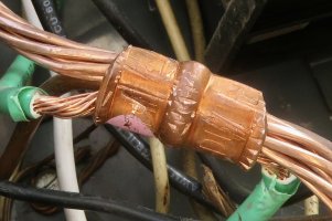

I had not seen a C-tap in use prior to the solar industry's misuse of C-taps,
Two wire maximum and there is a chart for selecting the correct tap for the wire sizes to be spliced.
Manufactures have a tool for crimping the tap. Pliers is not that tool.
Examples like these cause me to question everything about the project just a little more.
